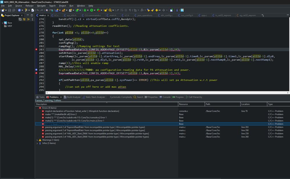

2026-04-03 2:03 AM
You have reached the limit for number of private messages that you can send for now. Please try again later.
I got this in the private msg so i will attach the snippet here
2026-04-03 2:11 AM
2026-04-03 2:41 AM
Hello @VanshajKaistha
From the screenshot I can see there are pointer type mismatch errors around the EepromReadData calls, but the image alone is not enough to give a precise fix. To diagnose this properly I need you to paste the relevant code as text, specifically: the prototype/declaration of EepromReadData from its header file, the type definitions and declarations of lc_param and pa_param,
