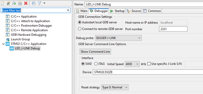

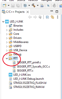

I would like to know How to configure the J-LINK Segger to work with STM32CubeIDE, after a little searching I found this video : https://www.youtube.com/watch?v=Rf-NKOoPYUc
But at 12:11 I can see this configuration in the video
But I don't have an Application directory :
In this case, do you have an idea how to do it ? Thank you for your helps.

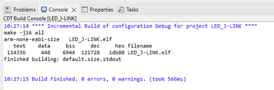

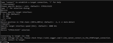

It's not the same, at the beginning I converted to J-LINK so I don't know if it's the same configuration :
Now I have an folder and no errors when compiling.
Now my errors is at the end to validate the operation. Now I try to connect

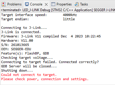

Now when I go into DEBUG mode there is an error, for me it is actually a hardware problem now since when compiling, I compile well with the J-LINK tool.
So do you have any idea now ?
2024-11-05 1:37 AM - edited 2024-11-05 1:45 AM
@Andrew Neil wrote:This error message:
tells you that it's the basic SWD hardware connection that's failing - it hasn't got as far as anything to do with RTT at that point!
Yes you're right but I have already configured the tool now I will check again to see what it gives. After checking nothing is works
that I try to connect via SWD or JTAG nothing works, so it is normal that STM32CubeMX cannot communicate with the J-LINK
2024-11-05 1:55 AM - edited 2024-11-05 1:56 AM
@DYann.1 wrote:Yes you're right but I have already configured the tool
So this is not about the tool configuration - it is a basic hardware problem:
Are you also going to complain to Segger about giving you "useless" (sic) links?
When the basic hardware connection is not working, nothing which needs to use that connection can work!

2024-11-05 4:31 AM

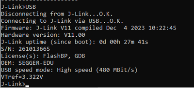

I don't see your video link but one thing what I am certain is that the connector is compatible with the evaluation card. When I connect with J-LINK and USB_STLK :
Now when I need to only with J-LINK for program and Debug (without USB_STLK) I have this picture :
2024-11-05 4:39 AM - edited 2024-11-05 4:52 AM

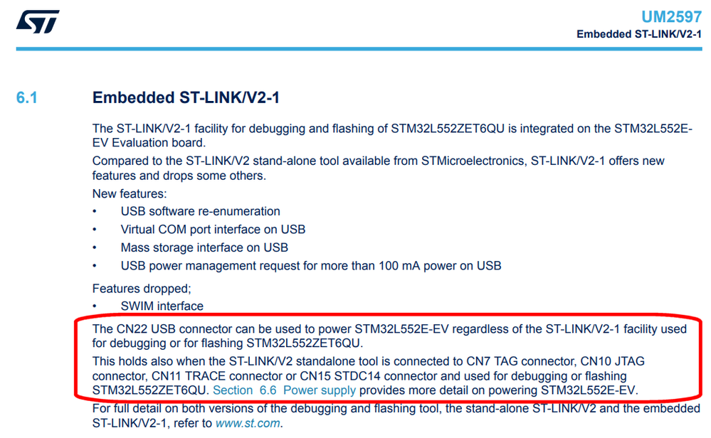

Hi, thank you every body now I can work with my J-LINK . In fact in any case I
I still have to connect USB_STLK even if I don't use ST-LINK (from what I understand).
operation is correct
2024-11-05 4:47 AM - edited 2024-11-05 4:48 AM

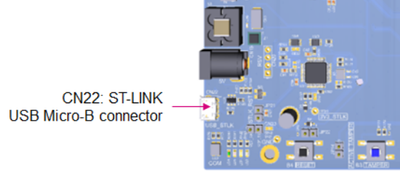

2024-11-05 4:54 AM

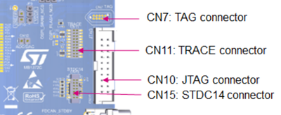

On my EV board first after I can switch to my real board. "USB_STLK" look on the evaluation card where the connector is located "USB_STLK"
2024-11-05 5:16 AM
OK, so that's CN22 - the micro-USB for the on-board ST-Link.
and you're connecting your JLink-EDU to the CN10 JTAG connector:
Yes?
So you're using CN22 to power the board:
