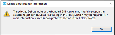

I would like to know How to configure the J-LINK Segger to work with STM32CubeIDE, after a little searching I found this video : https://www.youtube.com/watch?v=Rf-NKOoPYUc
But at 12:11 I can see this configuration in the video
But I don't have an Application directory :
In this case, do you have an idea how to do it ? Thank you for your helps.
Regards

Again, the folder structure of the project doesn't have any effect at all on the debugger connection.
So having (or not having) an 'Application' folder won't solve this:
Or this:

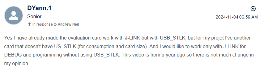

@DYann.1 wrote:Yes I have already made the evaluation card work with J-LINK but with USB_STLK, but for my projet I've another card that doesn't have US_STLK (for consumption and card size).
So which one is giving the connection error - the EV board, or your custom board?
