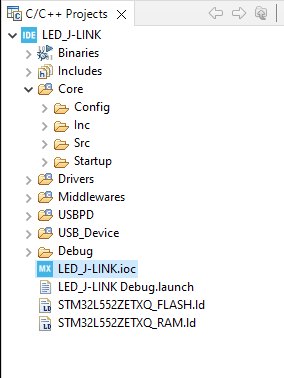

There is something I didn't understand
I have this picture and I don't have the Application directory
where did you see the Application directory ?

@DYann.1 wrote:I have this picture and I don't have the Application directory
That is the default folder structure that CubeIDE creates.
Here is a description of what is in each of those folders:
Here's an example with a custom folder added:

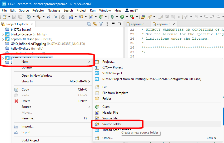

In that example, I called my folder "common" - you could call yours "Application", if you wish.
To add a custom folder, right-click the Project name, choose 'New', then choose 'Source Folder'
Note that you need to choose 'Source Folder' if it's going to contain source files that you want to be included in the build.
For other files (that will not be built), you can use the plain 'Folder' option.
