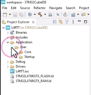

I would like to know How to configure the J-LINK Segger to work with STM32CubeIDE, after a little searching I found this video : https://www.youtube.com/watch?v=Rf-NKOoPYUc
But at 12:11 I can see this configuration in the video
But I don't have an Application directory :
In this case, do you have an idea how to do it ? Thank you for your helps.

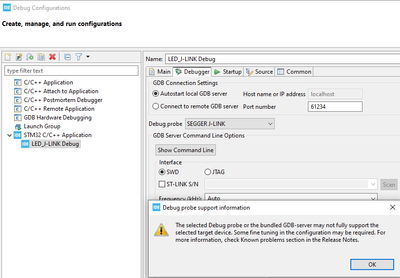

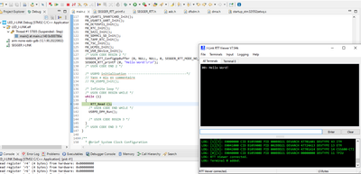

2024-11-04 5:02 AM - edited 2024-11-04 5:08 AM
I have this picture
I'll continue to see if there are any errors. And I have this picture
So maybe you should follow the video

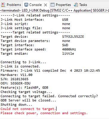

2024-11-04 5:12 AM
So what target device are you using?
What board is it on?
On resolving debugger connection issues:
https://wiki.segger.com/J-Link_cannot_connect_to_the_CPU
https://community.st.com/t5/stm32-mcus/how-to-solve-debugger-connection-issues/ta-p/49693

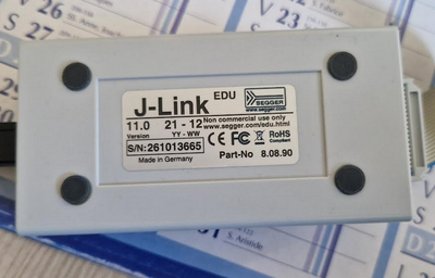

2024-11-04 5:21 AM
@DYann.1 wrote:
Is it a genuine JLink-EDU? there's a lot of fakes about ...
Does it connect using Segger's tools?

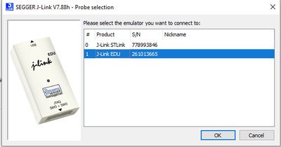

2024-11-04 5:26 AM - edited 2024-11-04 5:40 AM
Yes of course, It's a genuine JLink-EDU, I have a STM32L552E-EV Board.
I just need to work with STM32CubeIDE for Debug and program

So how to find
How to switch to an equivalent of this window ? I think the STM32CubeIDE is the old version.

@DYann.1 wrote:Yes of course, It's a genuine JLink-EDUrogram
I'm afraid that is by no means a foregone conclusion - there are many fake J-Links.
@DYann.1 wrote:I just need to work with STM32CubeIDE for Debug and program
But confirming whether or not it works with Segger's own tools would tell you whether this is just a CubeIDE problem, or something more fundamental ...
@DYann.1 wrote:How to switch to an equivalent of this window ?
That's the Project Explorer - you should see that to the left hand side when you first start CubeIDE
