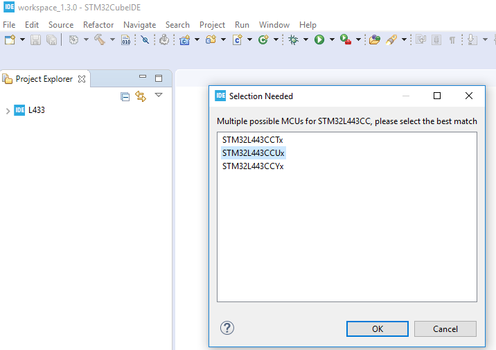

When importing my old project from True Studio to Cube IDE I get the dialog where I need to specify the processor in use (see picture).
From this dialog I can not move on, no matter what i choose, one of them, all of them or none of them, or in different combination: when I click ok, the same dialog pops up again. When I click cancel, i pops back up and when I try to close it it comes back up. A have to shut Cube IDE down with task manager.

Got a try with TrueStudio 9.3.0 for STM32 creating a project targeting STM32L433CC device.

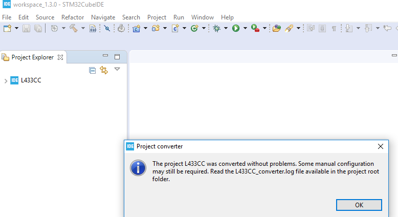

Import within STM32CubeIDE works fine for me.
As shared I'm getting too a dialog asking me to select my device to be mapped to STM32L433CC original one. Selecting one is allowing the process to complete successfully.
Please notice I've to specify twice my device mapping because I guess I've x2 build configurations within my original project (Debug and Release).
