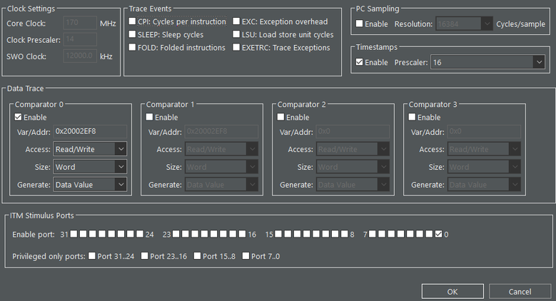

2024-04-10 1:48 AM - edited 2024-04-10 1:54 AM
Updating to the ST-Link current latest version 3.14.5 fixed the issue for me. Try that first before attempting to downgrade your ST-Link. I have testet this with an STM32G491RE-Nucleo and STM32CubeIDE version 1.15.
Hope this helps :)
Edit: Clock speed should not be an issue, I have testet it at 170MHz. The clock is anyway prescaled down as shown in the upper left under "Clock Settings".

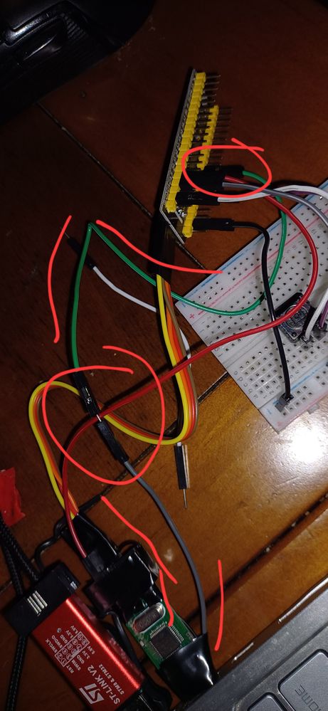

HARDWARE SETUP:
A STM32 board + ST LINK v2 clone

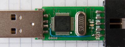

I used the Chinese Clone, followed this tutorial to solder the PA10 pin == SWO pin to a wire than THEN is to be connected to your STM32's PB3 pin which is the SWO to USB Virtual Com Port VCP connection, basically where the ITM_SendChar() usart function is sending its serial data to.
Note: Soldering it is not impossible but actually quite hard, took me about 90 minutes of soldering with my thinnest soldering tip, then find my thinest wire, and solder under the phone in macro mode, did not have a magnifier, to see what I was doing.
Pretty much the smallest solder I've ever done. But well it worked.
Tutorial here to jhelp with the soldering and locating the pin.
Location: 6th pin from the bottom of the picture, 7th pin from the top end of the picture.
It is a tiny tiny pin and soldering takes patience... I did it im no solder expert, got basic iron, did not use a binocular but if you have one use it, or else use the phone in macro mode and use a coffee mug or piece of wood to hang the phone then work underneath it. USE the MACRO mode on you phone, much better definition image close in macro than zooming in in normal mode.
https://lujji.github.io/blog/stlink-clone-trace/
However the tutorial is not instructing you that the T-SWO pin / PA10 / pin 32 on ST Link v2 needs to be connected then to your PB3 (by default) pin on STM32F411, as this is the default for SWO, this tutorial mentions it:

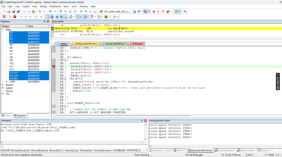

}2. Alternatively I believe this work for CubeIDE, and for keil redefine _write(), here i have done both, to be sure and it works.

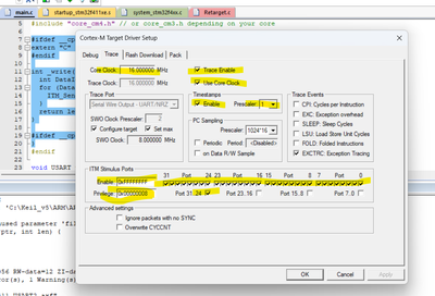

3. Setup your IDE. in this case Keil IDE with the following Trace setup:
- Speed 16MHZ for my STM32f411CE it worked. I believe the speed however is not essential. check your system clock speed by checking the SystemCoreClock variable.
- What is essential is to ENABLE the Trace.
- Check to use the Core clockb
- ESSENTIAL : Select ALL of the ITM stimulus bits 0 to 31. In the past I used only 0 as recommended by many tutotials: DID NOT WORK ! Figured out it was the element that prevented the whole thing to work ! so set it to 0xFFFFFFFF
- Finally set the privilege mask to 0x00000008.
Note others report using only bit 0 stimulus 0x00000001 and then privilege 0x00000000.
Try both !
Screenshot of important values below: Essential value in Yellow.
4. Like mentioned earlier, print something in the while loop in order to be able to test your output.

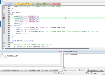

Ok so now you have done the 1. soldering of SWO on your ST link v2 clone, you have connected it to your STM32 PB3 SWO pin, but then you have no clue as to is it gonna work or why is it not ?
And my word this is where all the tutorials I found thus far were coming short : not telling you anything about testing, and diagnostic of 1. the HW connections then the 2.software
Showing the system clock using SystemCoreClock here:
HOW DO YOU TEST that the SWO Connection is working ?
As below highlighted in REd the ST link v2 clone SWO / PA10/31 pin to SWO/ PB3 on STM32F411 connection, it is breakable : 2 parts wire.
Note: no need to connect it through the header of the St link clone, it is another risky, risk of damaging the clone for no reasons, when you can just add a new wire like i did 1. simpler 2.faster 3. does not force you to sacrifice one of the existing header pins and connection.
This test is missing from ALL the tutorial I found !

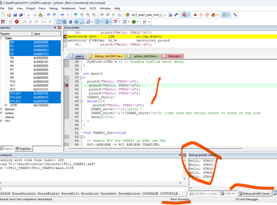

- Once you have configured your IDE (as below) and printf() redefinition (as below) , then EVEN if your settings e.g. TRACE Clock wrong or ITM Stimulus bits are wrong, You will still see data coming through to the Debug window SWV viewer window in Keil or Cube IDE.
It will not print meaningful ASCII Chars, only incoherent characters but you will see the data incoming, and can switch to HEX view mode to check that data is sent.
Wrong chars but data coming yay !
if the speed of your clock is too fast it might fail without showing anything due to being unable to sync with viewer. So my advice on testing clock speeds: Start with the lowest to the greatest e.g.
// 100 96 84 80 50 48 32 24 25 16 MHZ. =>> 16, then 25, then ... lowest first.
So TEST: in the while(1) loop in your main: add endless printf(xxx) statements until you see something.
This is the VERY FIRST KEY step, that is not explained anywhere pretty much, that I figured out of luck and a tiny bit of experience debugging sh**ty stuff.
ADDITIONAL TEST, very helpful BREAK THE SWO WIRE ON AND OFF see what happens !: I set up a breakable wire in 2 parts, that I played with to disconnect while running the Keil IDE SWV debug trace viewer and indeed when disconnecting it the data stopped coming immediately on the viewer and then resumed instantly once reconnected.
So yes these 2 Hardware test steps, testing that your SWO pin is spitting data out, is the very first thing.
