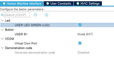

I am trying to create some example code for a Nucleo G474RE board and one of the initialization steps was whether I would like to use the BSP for the Virtual COM port, user LED and user button. Note that this is what the configuration looks like
Building straight out of the box we run into a build error where it cannot find COM_InitTypeDef. This is because the USE_BSP_COM_FEATURE macro is not set to 1. If I hand code this to enable the COM feature, I run into a second build error where this code is generated

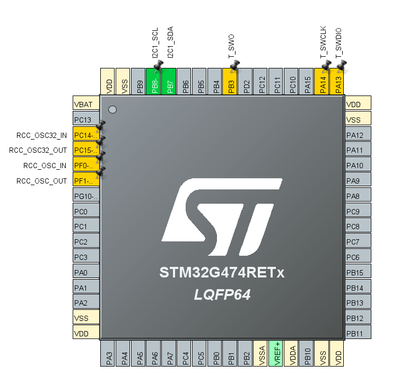

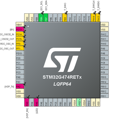

And now for the other interesting bug I found.
Below is a pinout view at this point in time.
To kind of fix this, I then go to the Bsp category, click on NUCLEO-G474RE and uncheck the Human Machine Interface. This then, rightly removes the reservation on the pins for the UART, LED and Button
I click Save and then Build. No more errors. But I want the BSP enabled so I go back an enable the Human Machine Interface. The pinout configuration remains the same, as per the above config even though the LED, Button (Set to EXTI) and VCOM port are checked. This behaviour I do not believe is correct so I uncheck and disable the LED, Button and VCOM port and then reenable them, when I do this, the pinout view now shows the expected reservations.
