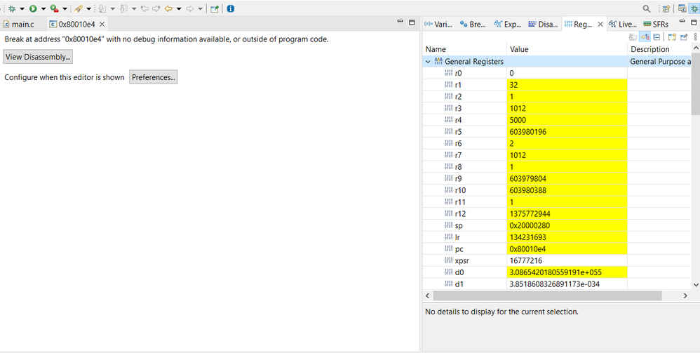

When I try to run the sample code for LED Toggle from external flash memory, which is provided in the STM32CubeH7RS package by ST at the link [https://github.com/STMicroelectronics/STM32CubeH7RS], I get the following error:
Break at address "0x80010e4" with no debug information available, or outside of program code.

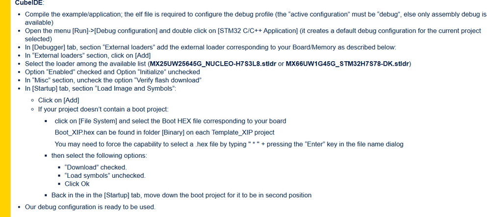

I followed the steps mentioned in the below **README file**
However, I can load & debug the program to the external flash using the method shown in this video: [https://www.youtube.com/watch?v=sPiFBzvCWfI&t=1422s]

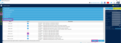

Hello @Sajidaap and welcome to the community,
Please make sure that XSPI2-HSLV is "Checked".
Could you try to use the STM32CubeProgrammer to check the value of XSPI2-HSLV option byte.
Please let me know if the issue is solved or not.

Hello @Sajidaap,
The HSLV is only activated when VDD ≤ 2.7 V. This feature shouldn’t be used at a voltage higher than 2.7 V, it can lead to unexpected behavior.
The I/O HSLV configuration bit must not be set if the I/O supply (VDD) is above 2.7 V. Setting it while the voltage is higher than 2.7 V can damage the device.

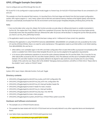

As mentioned in the readme file for GPIO_IOToggle, XSPI2_HSLV=1 I/O XSPIM_P2 High speed option enabled.
