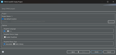

I am trying to add CMSIS FreeRtos to empty project. But I can see that .ioc file is not generated under my project.
I have also gone through the posts who have encountered the similar issue. but didn't get the resolution.
While creating the empty project. There is no option for selecting Stm32 cube project or empty project. attaching the snippet for your reference.

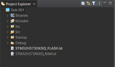

After creating the project successfully, I am getting the below build warning
warning: #warning "FPU is not initialized, but the project is compiling for an FPU. Please initialize the FPU before use." [-Wcpp]
So, I request you to guide me to resolve this issue.
