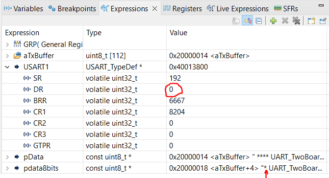

The UART1_TX function does not seem to work in the function HAL_UART_Transmit():
/*##-2- Start the transmission process ######### */
if(HAL_UART_Transmit(&UartHandle, (uint8_t*)aTxBuffer, TXBUFFERSIZE, 5000)!= HAL_OK)
Error_Handler();
}In particular, the IDE debugger shows that the UART data register (DR) does not change during the following char assignment, as the DR value is always shown as 0. See the Debugger screenshot at the bottom.
else
huart->Instance->DR = (uint8_t)(*pdata8bits & 0xFFU);
pdata8bits++;
huart->TxXferCount--;Increasing the TX-buffer pointer (pdata8bits++) and the counter (TxXferCount++) works, so the correct characters should be written to the UART1->DR.
Question:
* How to confirm that DR is actually being updated?
* Should this work in Debug mode?
* Is the DR cleared immediately after transmitting the data?

2023-06-23 2:51 PM
The DR register is NOT a memory, it is a window on the logic of the UART.
A write to DR goes into a buffer and shift register for transmission.
What you read from DR is a similar arrangement on the RECEIVE side, so you're not looking at the data you wrote unless the pins externally loop back.
Also looking at DR in the Debugger will clear and change bit settings in SR, which reflect that received data has been read, and to now reflect that new data is available, or not.
You can read error and fault states, like framing, parity and noise, by inspecting SR. It is recommended that you have your code read this into a variable, and you then inspect the variable, in RAM
