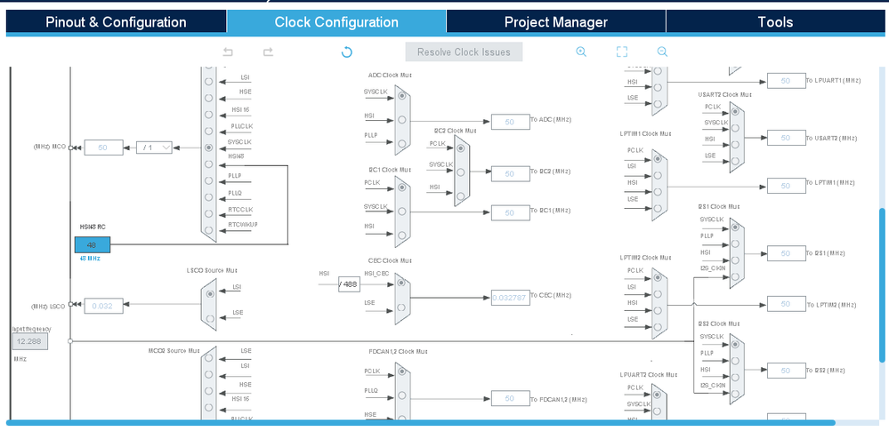

I'm trying to communicate with external device using SPI, but I'm not getting any SPI peripheral clock at configuration level and there is no clock initialization details in SPI Init();

I'm not sure what you're showing us here, perhaps a misunderstanding?
HAL_SPI_MspInit initializes the pins, that's it. The peripheral initialization will be in MX_SPI1_Init which calls HAL_SPI_Init. The function MX_SPI1_Init should be in main.c.
