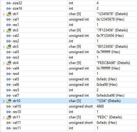

When I attempt to read an 8 character hexadecimal value with sscanf(), I get 0x7FFFFFFF for all values over "80000000". It's as if sscanf() is confusing signed and unsigned numbers. If I read the 8 characters as two sets of 4, there is no problem (this is my workaround). If I try this scaled down to 16 bits, there is no problem. If I put this same code in visual studio (with sscanf deprecation disabled), there is no problem. I'm just using "include <stdio.h>" to get sscanf() as it ships with CubeIDE.
The attached code snippet is for illustration. It only take lines 13-15 or 19-21 to recreate the problem.

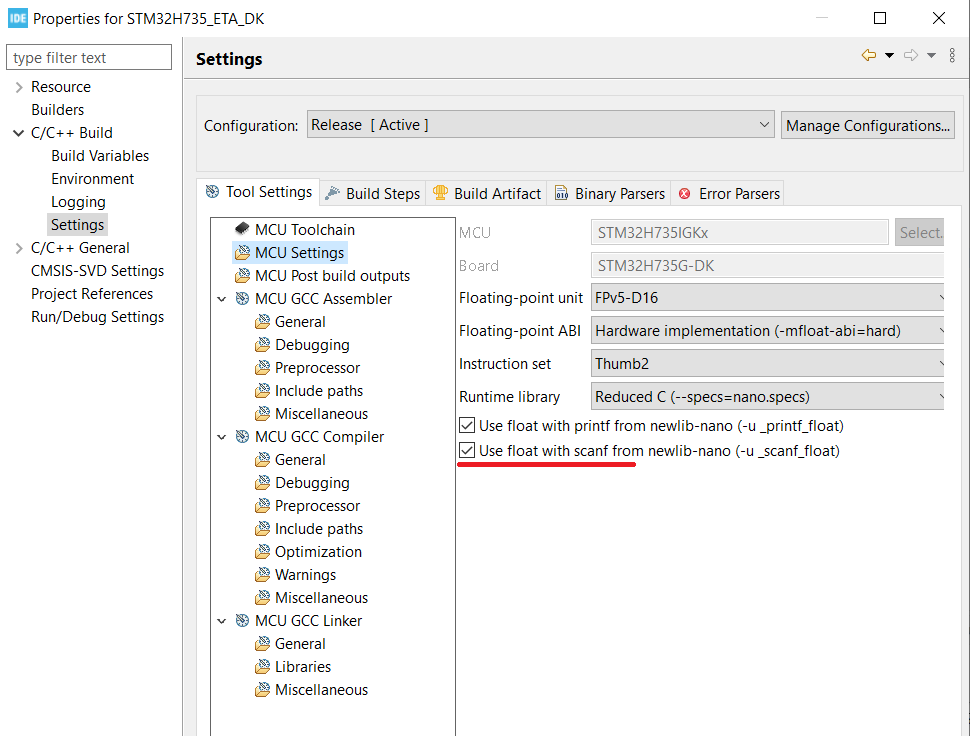

1st thing: try "%lX" in sscanf to read a 32 bit variable.
Next, try activating the float option in CubeIDE project settings, but I don't know if there's a connection between float and 32 bit integers with this option.

It looks like a UB - signed int overflow. strtoul() parses unsigned 32-bit correctly but strtol (signed!) gives the same INT_MAX.

@LCott.1 So you already had the lower case "%x" in sscanf, maybe now try "unsigned long" = uint32_t for the variables?
2023-04-04 3:59 AM
Maybe the "use float" also affects other 32 bit variables for scanf?

OK. Great. Lowe Case 'x' works fine but not Upper Case 'X".
We also played with the "Runtime library" setting above. With the "Reduced C" option, lower case x works, upper case X caps out at 0x7FFFFFFF, and 64 bit sscanf doesn't work at all ("%8llx" or "%llx").
With "Standard C" selected, Everything works correctly regardless of case or log or long long.
