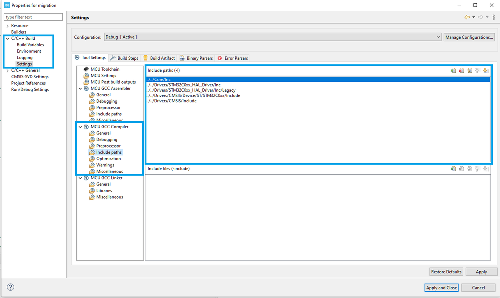

Make sure after adding new files to add the header files to the include path settings.
You can access this parameters by right click on the project the properties:

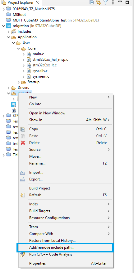

Or the easier way is to right click on the new folder containing header files and select "Add/remove include path..."
Hope this reply help you migrating your project.
