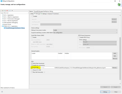

Hello @Andrei Chichak ,
Could you please attach the debug log file so that we can further investigate the issue.
You can find it under the Debug folder after enabling 'log to file' in the Debug configuration as illustrated in the screenshot below:
Thank you,
Souhaib
