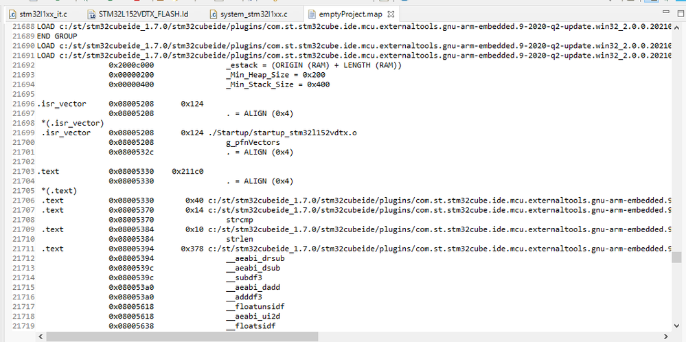

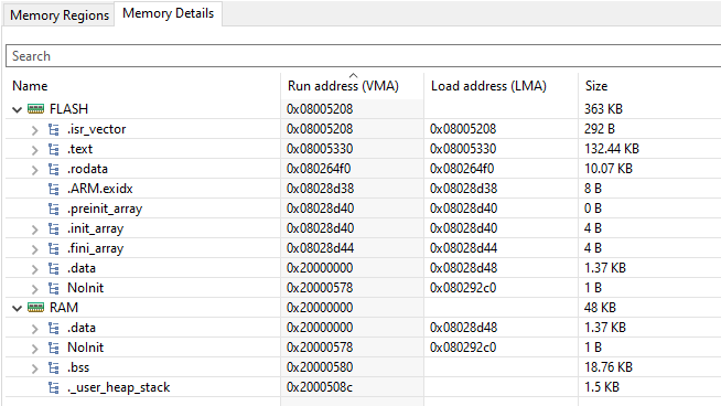

I still have issues trying to download the app into the board. From my application project, the resulting bin file always starts at 0x800 0000 although the memory shows that the app memory starts at 0x800 5208
And the output.map looks like:
I have modified the script files as follows.

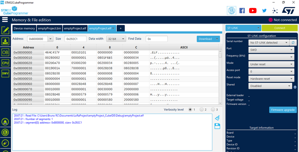

To give an example, when I read the elf file on STM32CubeProgrammer, I have the following info from my app project:
As can be seen, the app projects starts at 0x800 0000. There must be a subtle issue with my code but I do not figure out where.
Thank you for your help.
Regards.
2021-09-21 9:44 AM
The flash can be erased by sector so you must look at the STM32L152xD device reference manual and find the flash page size (sector size in kb) to allocate multiple of sector size for the bootloader.
If the sector size is 4K, you can keep 20K for bootloader for example. Or 24K if you need 21K.
Then, the same to begin the application in linker script, don't start appli at 0x0800 5208 but rather at 0x0800 5000 or 0x0800 6000 if it's a 4K sector size and that bootloader's limit is just before.
For the RAM, starting the 2 appli at the same address is maybe ok.
The startup file will copy data initialization in ram after the botloader has jump into the appli so maybe ok.
For the elf file seen in STM32CubeProgrammer, We can see .ELF in ascii in the first addresses so it is definitively not a good file.
You should see the stack at address 0x0800 0000 (value should be after 0x2000 0000) and then the reset vector at 0x0800 0004 (value should be after 0x0800 0000) and then all isr vectors...

I checked and the .map file is ok regarding where the reset vector starts. I still find myself in the situation where the app accesses diffrent starting address even when the linker and startup file are well defined.

Then, check on your hardware where you have routed these boot pins.
But it seems ok on the log, we see that it halts first at 0x0800017c so not a strange value.
Rgds,
Laurent
