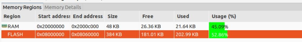

Besides, I have tried using STM32CubeProgrammer and even there the flash memory size is incorrect. Both platforms show that the flash memory size is 128 KBytes; I am using a STM32L152VD micro-controller. I have verified that the chip RDP is 0xAA (Level 0, no protection). For Openocd and ST-link GDB serve, I have tried different resent modes too.
In the Memory Regions tab, I have the following:
So, I do not know whether it is a code/program or a platform issue.
Thank you for your help.
