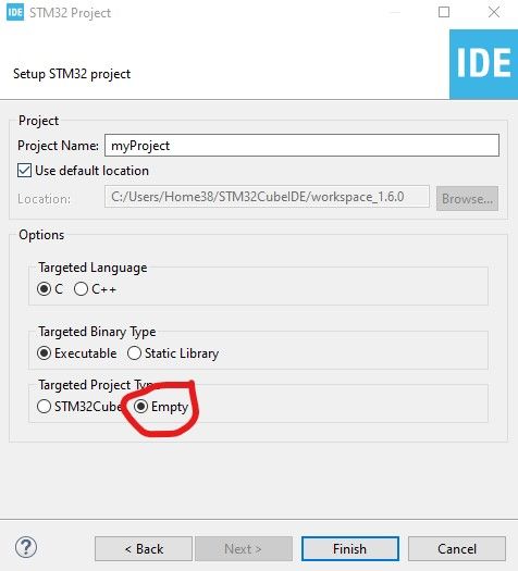

1) Let's create a brand new STM32CubeIDE so called "Empty": File > New > STM32Cube Project
Then up to you to copy / paste your .c/.h files and add proper setups to get a build running (defines, includes, ...) based on project properties

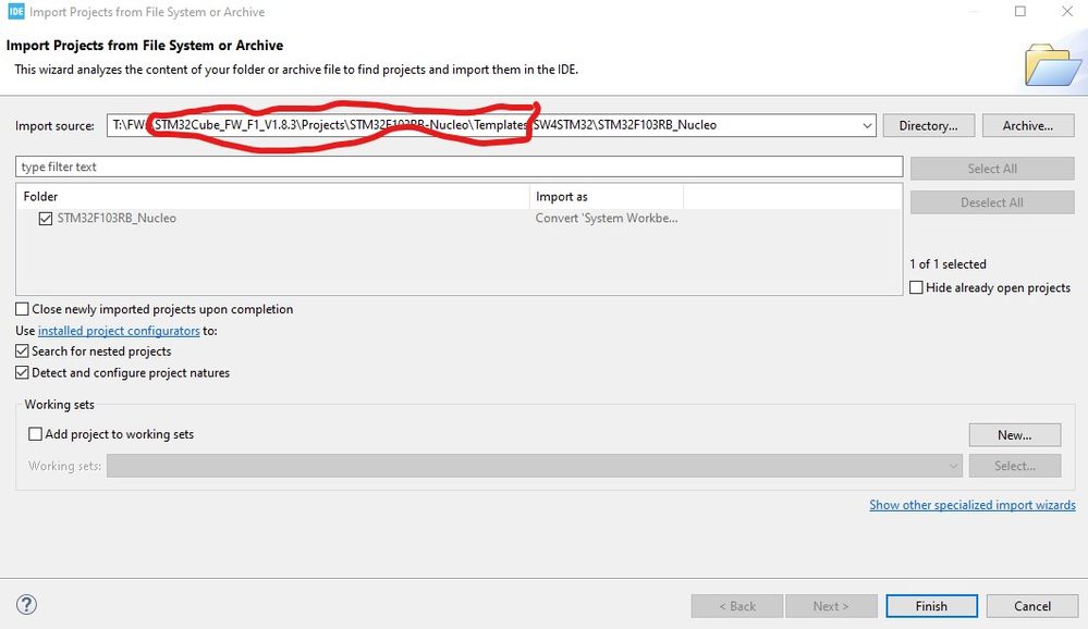

Or have a ty to import a "pre"-set project you can get from FW pack. File > Open Project From File System
Note: Select your serie and board you need
Then still up to you to copy / paste your .c/.h files and add proper setups to get a build running (defines, includes, ...) based on project properties BUT already all drivers dependencies and setup should be available to you

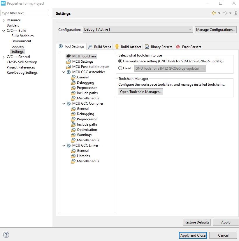

In addition, I have the startup code written in assembler *.s and it is my understanding that I have to modify it according to my project since this is IDE-dependent. STM32CubeIDE is capable of creating the makefile automatically. However, I also must work on it; specifically, I have to modify the compilation and linking flags.

1 - start with the STM32 toolchain, unless you must use generic ARM toolchain.
2 - yes
