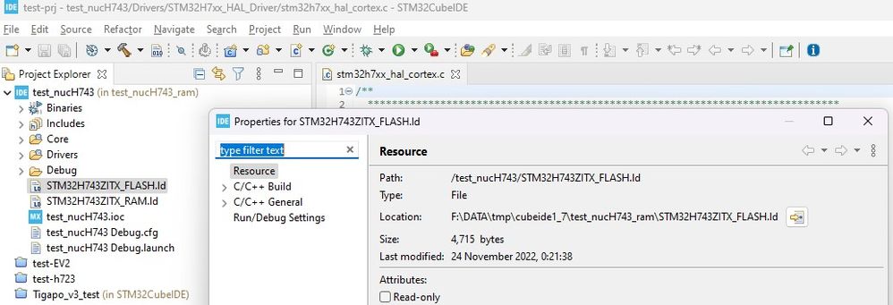

After importing an Eclipse project for 32F407, I notice that CubeIDE shows files from a different path to the path for that folder shown in it's properties (right clicking on the folder icon). It opens files from the different path, lets me edit those, but when it compiles, it uses those from the path shown in properties!!!
How can I fix this?

The file location in Eclipse can look "unexpected".
To see the real location, open the file properties and click on the resource tab.

Pavel, if you read my post you'll note that I already did that.

Again, note that a file in eclipse has a path in the "eclipse filesystem" and it differs from the real path in the OS filesystem

I already know what you are telling me about the Eclipse path and OS path, what's your point?
Eclipse is showing one file, letting me edit it, and compiling a file with identical name in a separate branch that I didn´t update.
Get it? Double click test.c, it open test.c, you edit it, build, but it builds using test.c in another path leg.
The path it uses for compile is invisible in the Eclipse window.
2023-01-06 12:01 PM
The question is how to change the path variable PROJECT_LOC, which is shown in the Properties/Resources->Linked resources dialog, but the edit button is greyed-out.
For some unknown reason the IDE is compiling from this directory if the file exists there, but if not it fetches from the correct source which is in another directory off the project root.
Double clicking on a file shown in the Project Explorer window opens files from the correct source directory, but it only compiles files from the PROJECT_LOC files.
PROJECT_LOC cannot be changed, it is a constant set by Eclipse. It points to the location of .project and .cproject files.
The root project folder is on the sources path... but then the builder would compile two .c files with same name, this would cause a linker error later. The other .c file is included in the project, so it must be compiled. Strange.
