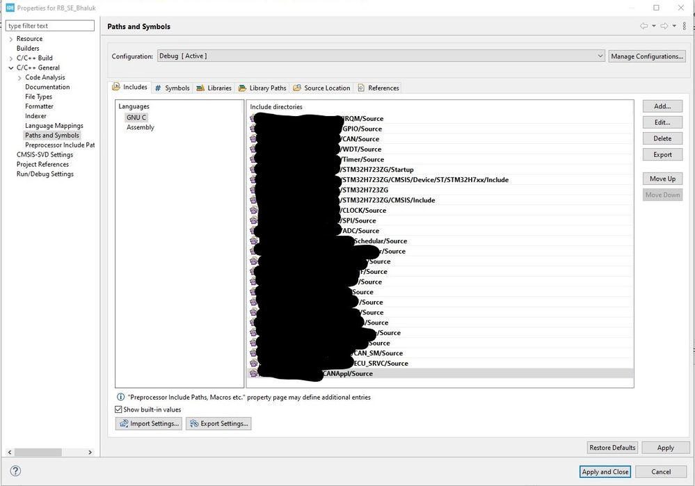

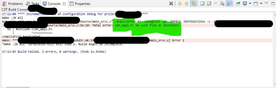

I started getting fatal error for the file which is in the project location. I have also added the path in the IDE.
I am attaching the screenshots which might be helpful for you to provide the solution.

Does the file exist? Where? Is that location included in your path?
Could also be an issue with spaces or non ascii characters in path.

Hi @TDK ,
Yes the file exist in the project folder.
I have included the path.
I am not using spaces, rather I am using underscores.

Do you have any non-ASCII characters in the paths? For example if the username contains non-ASCII characters? Can you access these paths outside of STM32CubeIDE context?

Hi @Markus GIRDLAND ,
The path contains only ASCII characters.

Hi @Markus GIRDLAND and @TDK ,
I found the solution to the problem.
The issue was in the include paths updated in the project properties were not reflected under folder hierarchy.
I used export option and that's all. It started working.
Anyways, thanks for helping me out.
