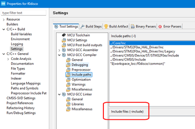

GCC and, thus, CubeIDE do also have that facility:
https://gcc.gnu.org/onlinedocs/gcc-13.2.0/gcc/Preprocessor-Options.html#index-include

You're right,
In the CubeIDE it is defined the flag -fcommon for the compiler
Is there a way to set it in IAR as well?
