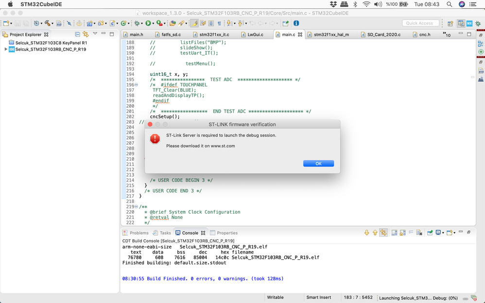

Have you updated your STM32CubeIDE product from 1.x.x release to 1.4.0 or brand new install ?

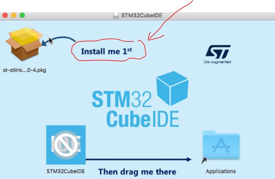

If update "only" I would have a try to perform a fresh brand new install taking care to install ALL proper material from installer.

2020-07-28 11:51 AM
Thanks a lot, Cartu38. That worked !!!:grinning_face:
