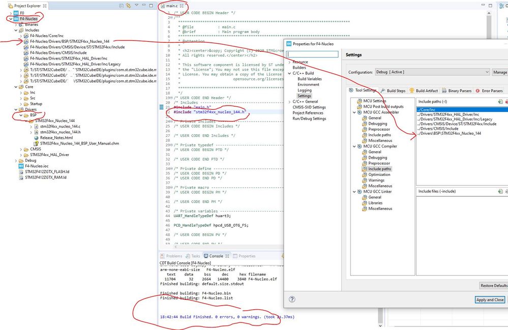

As addon here is my setup adding BSP without any issue

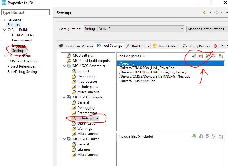

Project->Properties->Tool Settings -> MCU GCC Compiler -> Include paths Add "Drivers/BSP". It is visible as "../Drivers/BSP" Any suggestions as to how to make that line effective?

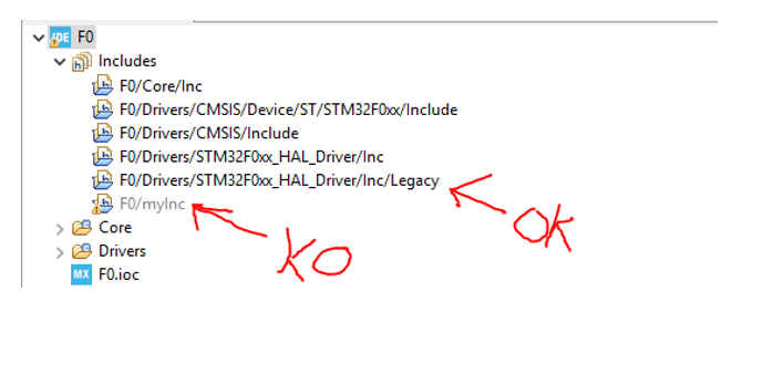

Is such line effective from Eclipse point of view already ? Please could you check if such line is leading to plain or grayed include like following sanpshot ... if grayed means Eclipse not able to reach
Thanks. Good find. I did find one bad directory which starts with a "/". How do I get rid of the bad one? How do I replace it with a good one with no '/"?

Right click on your project within Project Explorer then "Properties"
