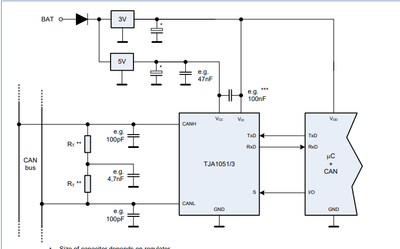

By the way, according to this schematic before I connect analyzer to stm32 board, the stm32 program works well but when I connect the analyzer to stm32 , an unrelated program is broke like button ınterrupt. I guess, there is a problem on my hardware.
From the beginning I suggest you to check this analyzer! It could be an issue from the analyzer. And still having a doubt regarding a possible issue on this HW. As I don't have one to run a test, sorry, I cannot tell you more ..
Also you need to check the bitrate from the analyzer side, are you sure you set the correct bitrate?

I want thank you all for helping. My problem is solved and I dont know my false :) . I guess this is a bug problem on stm32 cubeıde. I have a few questions about can bus hardware.
I will use tja1051t/3 as can transciever. Do I have to connect Vıo to 3V ? Is this a essential thing ?.
The second one, I will use common mode choke for EMI . Is it okey 51uH ? or should I use at least 100uH ınductance in every node ?
I could answer your first question: indeed you need to connect VIO of the transceiver with the VDD of the MCU to guarantee a good voltage levels between the MCU and the transceiver and exclude the issues related to VIH min when the MCU and the transceiver don't have the same power supply levels. This is why VIO pin is provided on this transceiver's package.
