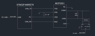

Here is my schematic
I observed the can Rx pin with a multimeter. The can Rx pin voltage is 4.88V when no receiving. When I send a message with other stm32 , can rx voltage increase 4.970V and the voltage stay in that value despite I send a data again. Then, I sent a data with analyzer to stm32 , the can rx voltage decreased 2,7V. that is so weird. In addition, when I connect the analyzer in Can Bus line, the stm32 boards doesnt communicate. It breaks the communication.

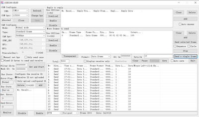

My analyzer software settings is right I guess because the can bus kbps is same 500kbps.

We cannot rely on a multimeter for this kind of debug. You need an oscilloscope for this.
Meanwhile you need to remove one 120ohm on the CAN but.
You need only two 120 ohm termination resistors at the extremity of the bus. So remove the one of the CAN analyzer.

I removed the 120ohm on analyzer but it still doesnt work. By the way, when I observe the can bus line with oscilloscope , what should I observe exactly ? How should signals flow on can bus line or Can rx pin ?

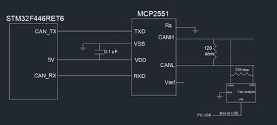

Lets say I observed the signals with oscilloscope, the ACK's second bit is not 0 dominant so the receiving is failed what will I do ?
By the way, according to this schematic before I connect analyzer to stm32 board, the stm32 program works well but when I connect the analyzer to stm32 , an unrelated program is broke like button ınterrupt. I guess, there is a problem on my hardware. You can check out my schema that ı am using and my codes.
