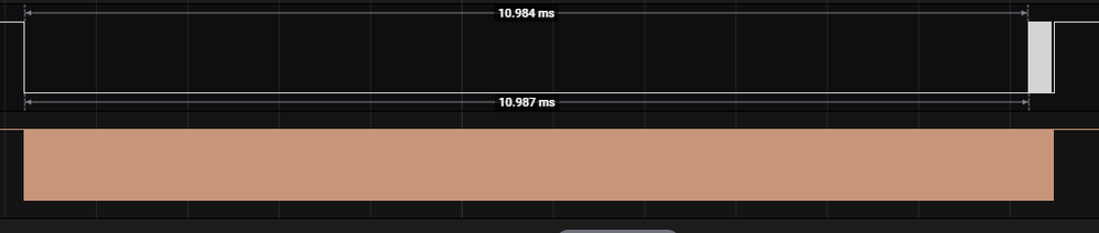

}and this is the waveform from my logic analyzer. As soon as I run the function MX_SPI1_Init() after enabling the SPI as a Slave the clock is generated. Orange is the clock and as you can see - from the 10ms delay -it gets enabled right after the initialization as master.
Any thoughts? I've been fighting with this issue for over a week, and tried many things
2021-04-22 4:35 PM
Hello
>> HAL_SPI_DeInit(&hspi1); /* Disables SPI and de-initializes the peripheral *
but in function definition, HAL_SPI_DeInit put device to slave mode and never deactivate it.
if sendHelloWorld is not a blocking function , such behavior may expected.
2021-04-22 6:25 PM
That solved it! The clock issue is solved, but I am getting inconsistent data at a slave node I have. My analyzer detects the data correctly but my slave node does not. I'll have to check that more.

2021-08-10 1:16 AM
Let me to comment with some delay the problem with target just to bring some notes for other readers here.
Above all, when perform whatever significant change of the SPI configuration, be sure the previous SPI mode is well terminated and SPI is disabled in according the RM prior any new configuration starts. This is even strongly required when change the data direction exclusively at half duplex mode!
As SPI slave can never produce any SCK signal, the observed long SCK pulse session confirms, that the configuration change was not successful evidently because such a permanent SCK clock flow is typical just for master Rx-only mode configuration (not for any slave one) .
Anyway, to better understand the SPI problematic, I suggest to read AN5543 focusing typical problems frequently reported by our customers.
Best regards,
Petr, the IP owner, STMicroelectronics
