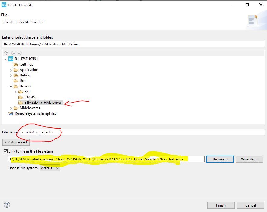

@Community member ok I've got a try myself to your STM32Cube expansion pack.
Doing proper import and adding HAL_ADC_Start(&hadc); to main.c I'm facing same issue as you.
Issue is not .h lack but .c one :)
Just add .c file and your project build is going to be successful !

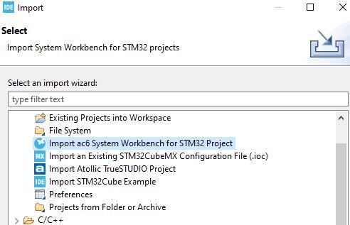

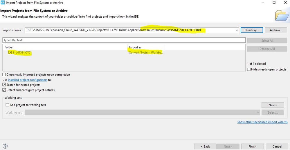

2020-07-29 2:45 AM
@MM..1 Such STM32Cube exansion pack is not STM32CubeMX compliant and as addon promoting SW4STM32 material not STM32CubeIDE one ...
FYI proper import working model is:

Solution is not .h but .c lack assuming you've rightly setup proper defines are shared previously. Setting reauired defines are taking care of .h include but still .c files are required from you.
