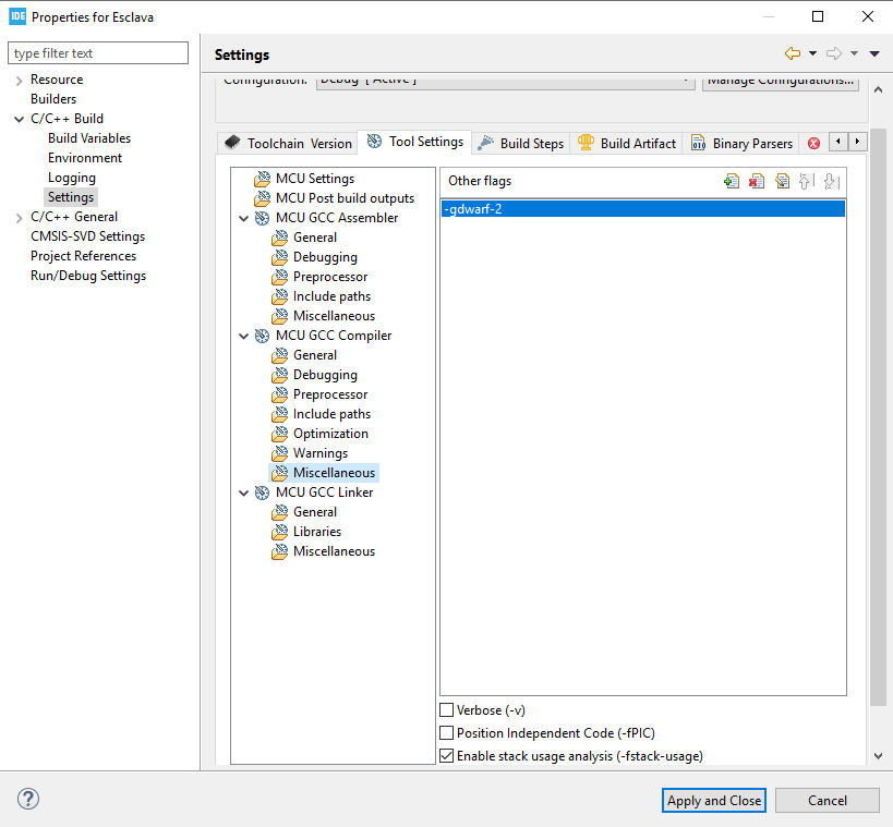

Finally solved, a more experienced friend found where to put the flag -gdawrf-2 in STM32Cube IDE and its shown in the attached picture
It was in the Properties -> C/C++ Build -> Settings -> Tools Settings -> MCU GCC Compiler, then the flag could be added in the Other flags fields.
After that we can debug code inside Proteus.

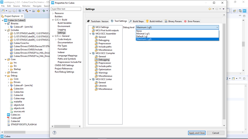

Originally STM32Cube IDE gives a .elf file but if I remember well the format is dwarf4 and I need dwarf2. in the options for the project in the IDE
like is seen in the following image can be seen the dwarf possible options to make the debug file but I think none of those are the needed options

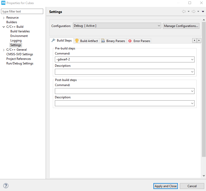

then I saw the tab Build steps and I after that I included the command -gdwarf-2 like is seen in the following image but it didn't work nor in pre-build steps nor in post-build steps.
Today I know (I think) that the error
gdwarf-2
make (e=3): El sistema no puede encontrar la ruta especificada.
make[1]: [makefile:81: pre-build] Error 3 (ignored)
is because make is looking for something that it coulnd't find and because of that the dwarf 2 file is not created but I don't know if I'm following the correct steps to do what I need, I really need detailed instructions because I'm very new to this. Even I don't know if I need to deactivate the default dwarf options shown in the first image to obtain the dwarf-2 file or I need to put some aditional route somewhere tho avoid the error "El sistema no puede encontrar la ruta especificada" (The system cannot obtain the specified path).
