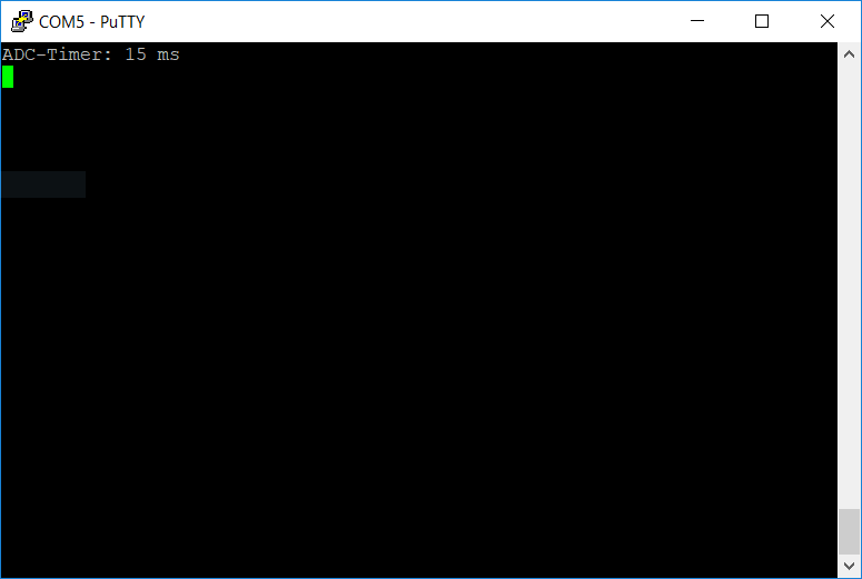

The Console Output:0693W000003BaODQA0.png
So It's working perfectly fine so far.

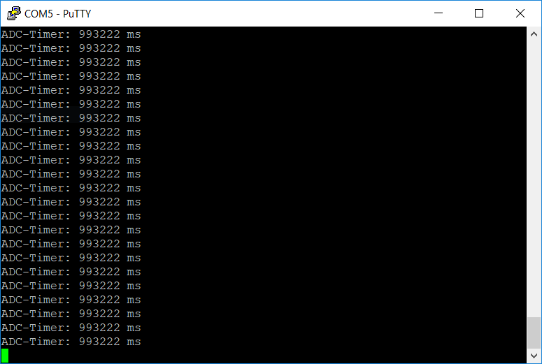

And the output on the console looks like this:
The Deconstructor of my ScopedTimer Class gets called once. After that the task never gets called again. when I pause the Program to step through it, I end up inside HAL_TIM_IRQHandler for TIM6 (Timebase Timer) and never return to my Thread.

The console output says ms but it's acutally µs. I forgot to change it after testing with HAL_GetTick() insted of m_timerHandler->Instance->CNT.
