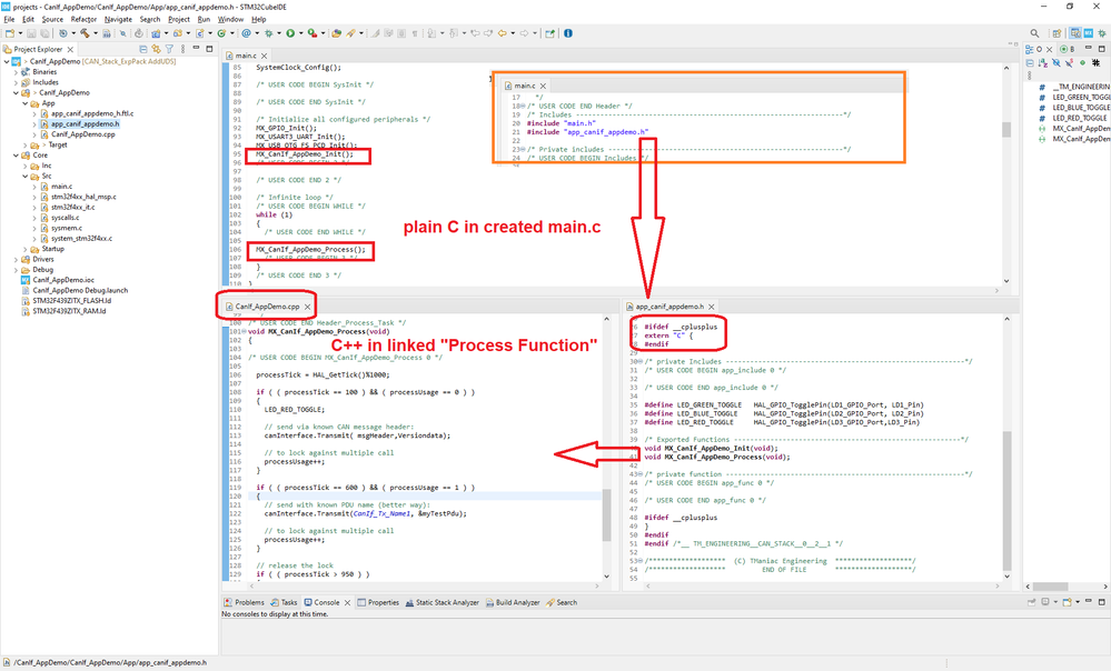

The picture shows my way (based on the STM idea). My "application", "Middleware" and "Driver" are written in C++.
The canInterface-"Driver" based on the plain C HAL.
