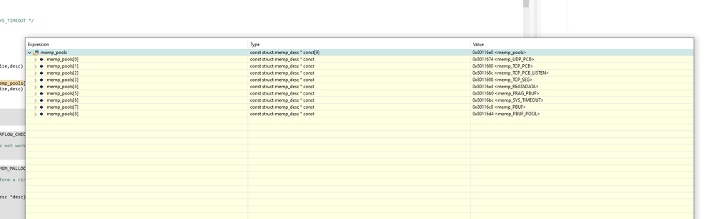

I have managed to get LwIP working and my Nucleo can be pinged and discovered via IP scanner tool. I want to get TCP/IP server working and I saw there are some files called TCP inside LwIP Library I just can get my head around it. But I have used TCPServerRAW that I got from a tutorial. Everything is fine until server need to transmit back, well until program wants to write into (probably unwritable) memory location. I just can't figure out where I can change those parameters so that TX pbuff dosen't end up in HardFault. I tried to setup MPU but I can't find locations soooo...

Ok, So I've tried to not use these files I have mentioned above and started a fresh project and used integrated into LwIP libraries. So after reading comments / instructions in tcp.c file I tried to create project with these instructions. But somehow I still get a HardFault.
So these are the steps:
also STM goes into HardFault at line 683 of tcp.c:
LWIP_ERROR("tcp_bind: can only bind in state CLOSED", pcb->state == CLOSED, return ERR_VAL);
