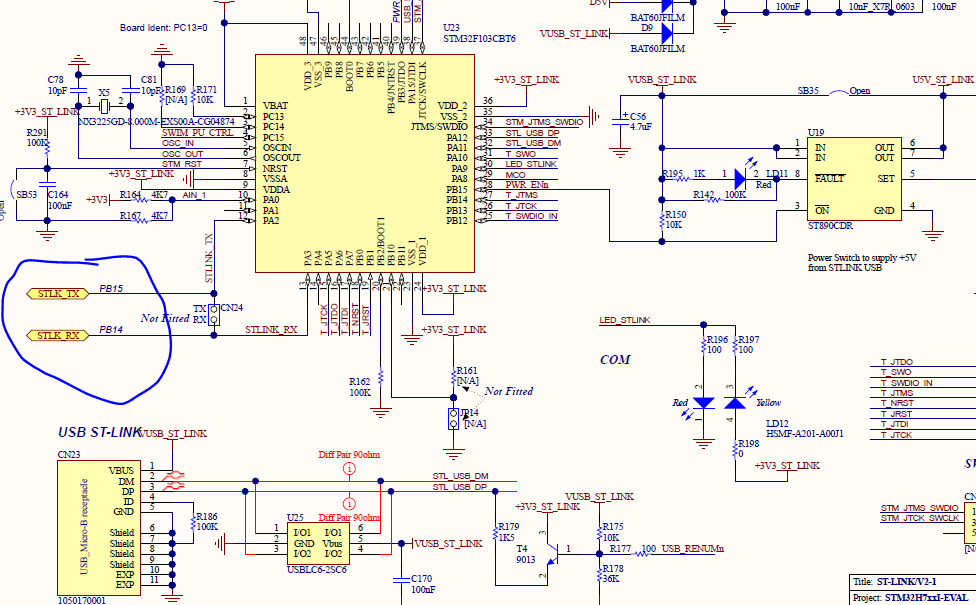

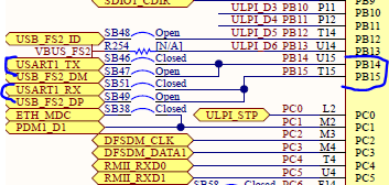

Show us how your Uart is configured, maybe post your code or something so we get a clear picture of your setup.
Quick question: are you using the correct USART1 port (pins PB14 and PB15)? (the one connected to your stm32h757i-eval's stlink)
https://www.st.com/resource/en/schematic_pack/mb1246-b0x_schematic.pdf
