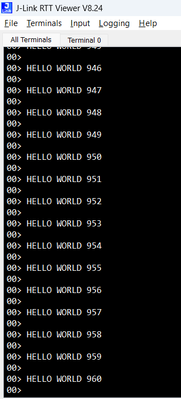

Thank you for the reply,I had used the Renesas microcontroller which will be using the Segger RTT for debugging.I would like to know is there any way of debugging the controller like that
2025-11-06 1:23 AM - edited 2025-11-06 1:49 AM
Yes, you can use Segger's RTT on STM32.
See the Segger documentation for details:
https://www.segger.com/products/debug-probes/j-link/technology/about-real-time-transfer/
It's proprietary to Segger so, if you have questions about Segger's RTT, you need to ask Segger:
https://www.segger.com/support/technical-support/
PS:
Note that RTT relies on J-Link - it won't work with ST-Link (or other debug probes)
