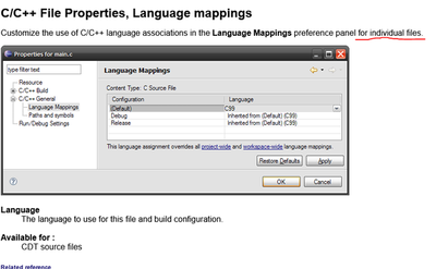

2024-12-03 12:58 AM
@ferro wrote:"Compiler options can be modified per file."
Where, how ?
As I showed earlier
2024-12-03 12:59 AM
As I said this does not work.
2024-12-03 1:18 AM - edited 2024-12-04 5:57 AM
Thanks,
Andrew Neil suggested the same : 1st is suboptimal and 2nd does not work as this setting is at project level not a file. [Edit] It is supposed to be per file but seems to not work as described

2024-12-03 2:02 AM
"Rightclick the file. Click properties. Click C/C++ General. Click Language mappings. Then select GNU C++ from the drop down menus."
Did you actually try this ? I did not get reply from Neil.
2024-12-03 4:07 AM
@ferro wrote:"Rightclick the file. Click properties. Click C/C++ General. Click Language mappings. Then select GNU C++ from the drop down menus."
Did YOU try this? I don't have your project. Since it says it overwrites project wide settings I think it only overwrites project wide defaults for that file. It wouldn't make sense if it would overwrite settings for other files. What would be the point otherwise? I only tried to see if my project had such an option, but I'm not going to modify it.
