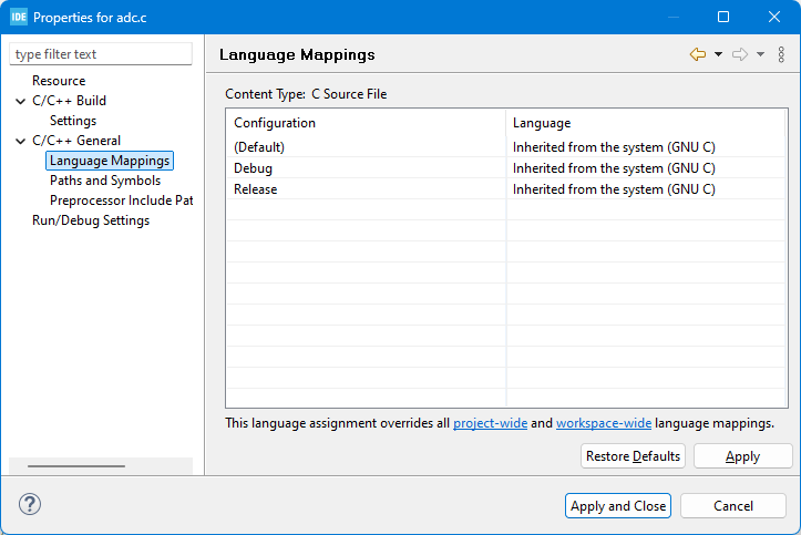

2024-12-02 6:39 AM
If you right-click the file and choose 'Properties', there's this:
Looks like generic Eclipse ?

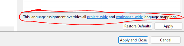

"If you right-click the file and choose 'Properties', there's this:"
Thanks. I set C++ there but adc.c is still treated as C.
Hm, Maybe clue is in what is writen at the bottom - seems that it is not per file.
If you can be bothered, could you try on your side, please ?

2024-12-03 12:55 AM
You can exclude the c file from build and include it in a new cpp file. That's an ugly workaround.
@ferro wrote:"Compiler options can be modified per file."
Where, how ?
Rightclick the file. Click properties. Click C/C++ General. Click Language mappings. Then select GNU C++ from the drop down menus.
