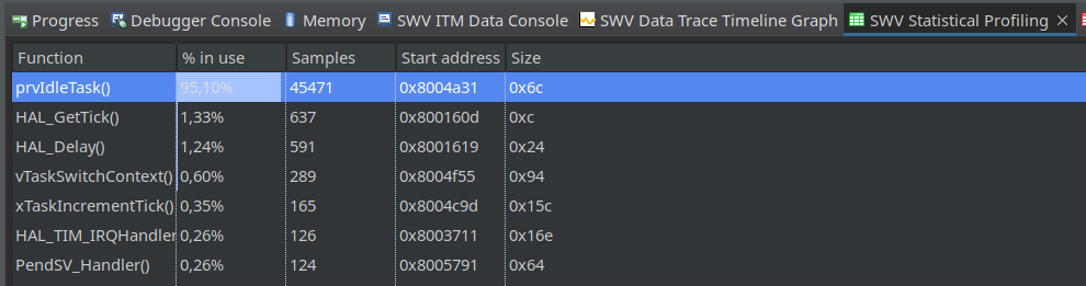

2022-12-27 8:06 AM
i followed this:
https://www.codeinsideout.com/blog/stm32/swv/#debugging
data trace can make problems, when too much events are generated;
i tried "CPI:..." and got a lot of overflows...so stopped using this.
otherwise no problems - until now. :)
