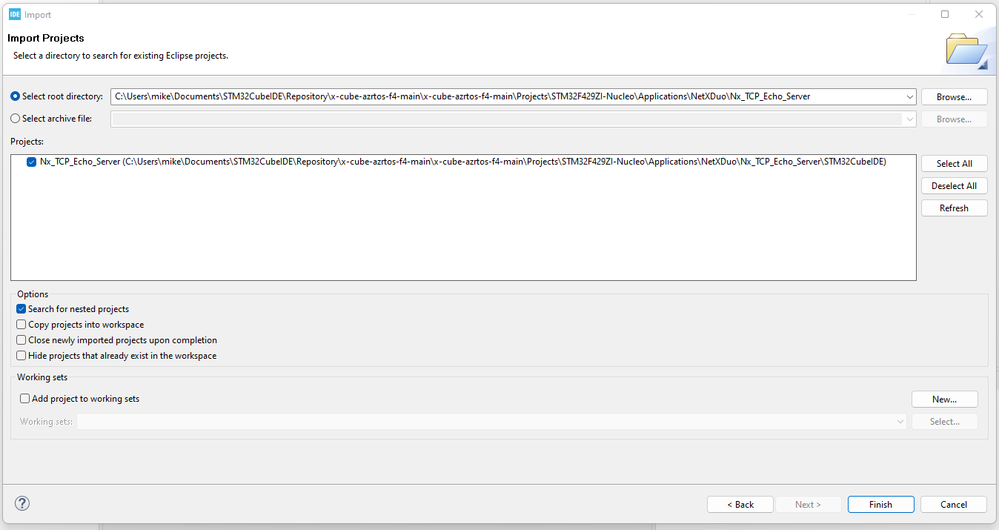

Just to add a bit more fuel to the fire....
Below is a screenshot of the Import window while importing an F4 version of the same example. Note that there is only one project available to "import". This project DOES import properly, compiles and runs properly. Why is this different from the H7 example?
