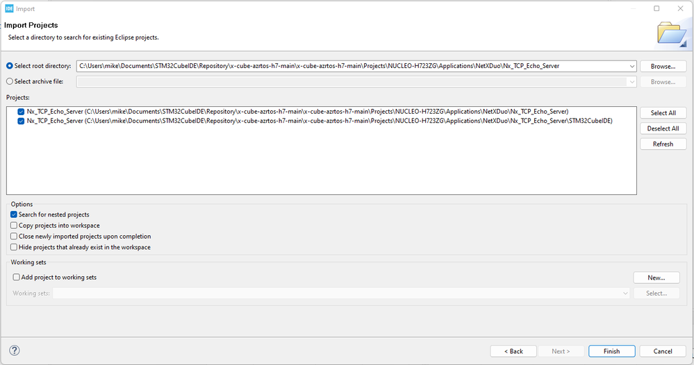

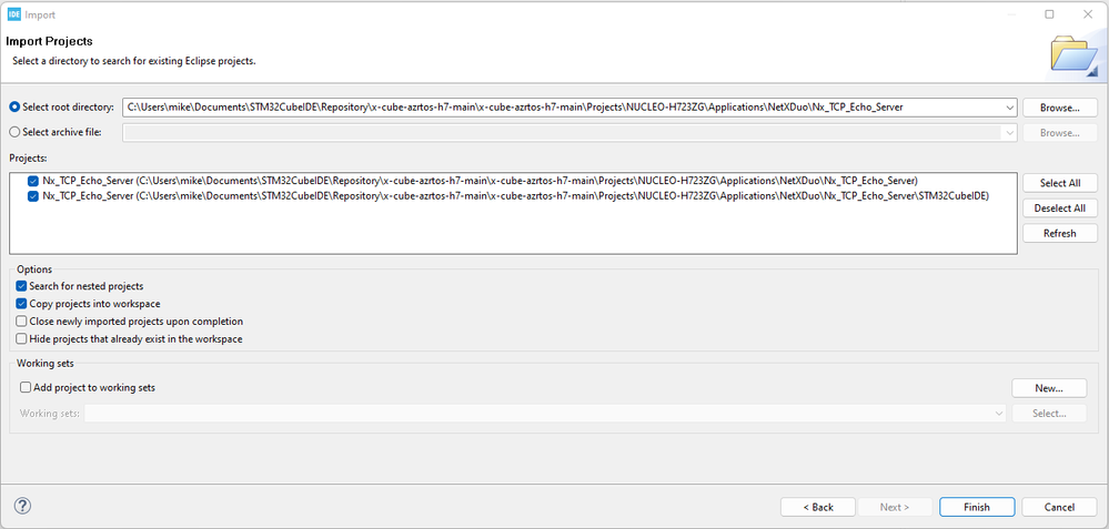

When using technique #1 I get two "projects" in the import window:
If I select BOTH projects, I get the following error message.

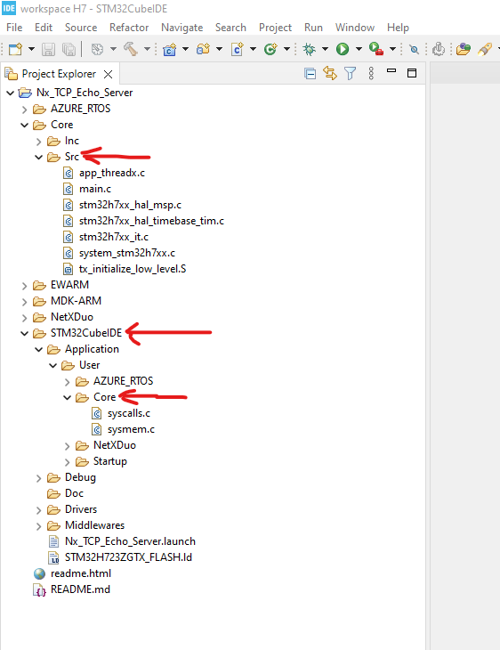

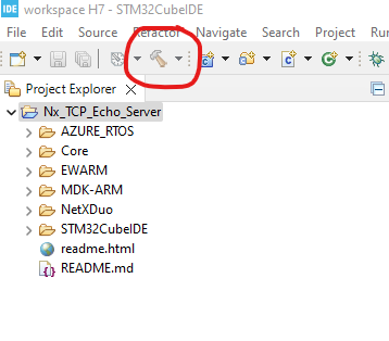

HOWEVER, the projects have been imported and all example files do exist in the workspace H7.
BUT, the build hammer is greyed out and i cannot build the project.
So if I erase the ..metadata file and all contents on the workspace H7 folder, then attempt to import ONLY the STM32CubeIDE project, I get the following. The yellow exclamation point apparently means the "file does not exist".

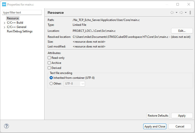

This is confirmed by looking at the "resource" in the project properties window (resolved location).
Upon examining the workspace H7 using windows file explorer, I find that none of the files have been copied over. So apparently I DO need both projects, but am not able to import them because CubeIDE still thinks they exist in the workspace H7???? And the build hammer is greyed out??

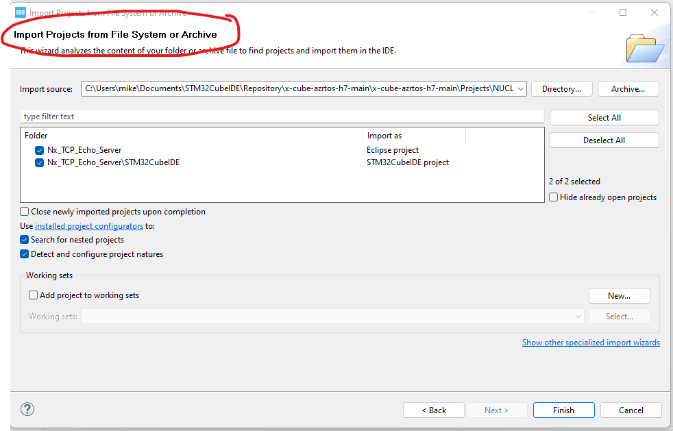

So if I attempt to use import method #2 above, I get the following:
Again it show two projects to import. But it does not show a way to "copy" the files into workspace H7.

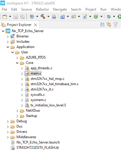

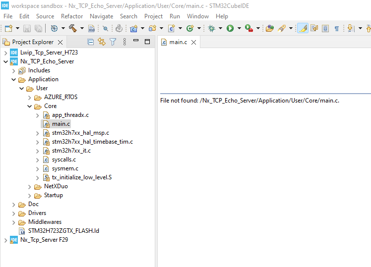

After importing using methods #2, i get the following project file structure.
Once again, build hammer is greyed out so that I cannot build the project.

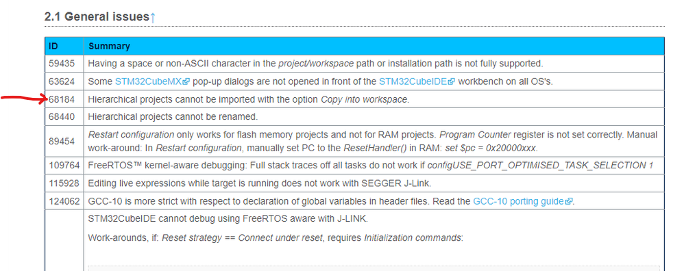

So, here is part of the problem I am seeing. I guess this renders "hierarchical" example projects useless until this is fixed.

Finally to answer your question: How to import example from GitHub?
AFAIK this is straightforward only for examples where all components are in the "jumbo" MCU package available on github,
Your example cannot be installed just by clone or download from github, because it uses additional pack X-CUBE-AZRTOS-H7.
It needs the CubeIDE "pack installer" magic to get these X packs into the correct places.

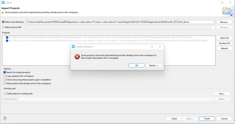

NO! There are always two projects shown in this window. So apparently, this example is a "hierarchical" project. Below is what I see.
If I then click on "Finish" I get the following error message.
This happens every time, even with a clean (i.e. no files) in the newly created workspace.
