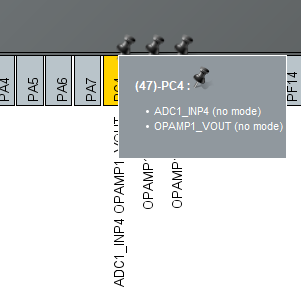

OPAMP1_VOUT is on pin PC4 and I can select ADC1_IN4, I think this should route the OPAMP output directly to the ADC?

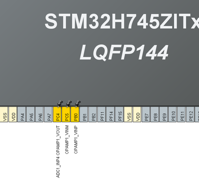

Within IOC if I select OPAMP1 I see PC4 has OPAMP1_VOUT in green and PB0 has OPAMP1_VINP in green.
Moving to ADC1 I can select IN4 as OPAMP1 Output Single-ended and that appears in yellow under the pin allocations.
ADC1 still shows a yellow triangle.

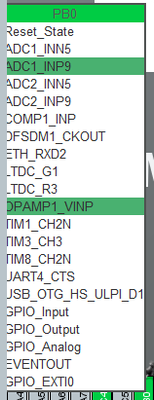

It suggests the following to remove the yellow triangle:
This seems to suggest that I should connect ADC1_INP9 to the same pin as the opamp input? That doesn’t seem correct to me. However if I do select that both are now highlighted in green

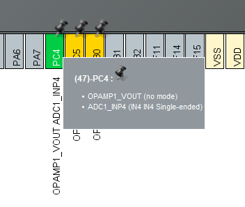

Yet the important one, PC4, OPAMP1_VOUT is green yet the ADC input, ADC_INP4, is still yellow?
In summary I think this is a question in two parts, how do I connect the OPAMP1_VOUT to ADC_INP4?

1°) To be able to configure the OPAMP1 and ADC1, you must first configure the GPIOs in the Pinout View.
Right Clic on PC4 and choose OPAMP1_VOUT.
Right Clic again PC4, then press Ctrl and choose ADC1_INP4.
Right Clic on PC5 and choose OPAMP1_VINM.
Right Clic on PB0 and choose OPAMP1_VINP.
2)° Then select ADC1, enable Cortex-M7 (or M4)
Enable IN4 Single-ended, PC4 change from yellow to green.

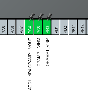

3°) Then select OPAMP1, mode PGA Connected-INVERTINGINPUT_IO0.
PC5 and PB0 change from yellow to green.

If you want to use OPAMP1 in Programmable gain amplifier (internal PGA) mode, in STM32CubeMx you should select OPAMP1 Mode = PGA Connected-INVERTINGINPUT_IO0.
In this case, the programmable gain is 2, 4, 8 or 16 (OPAMP1 Parameter Settings Tab)
This configuration will expose the following GPIO assignment.
PC4: OPAMP1_VOUT
PC5: OPAMP1_VINM (must be left unconnected as the PGA is internal and where the resistor bridge is referenced to VSSA, see Figure 228 in RM0399 )
PB0: OPAMP1_VINP, connected to your microphone (referenced to VSSA)
