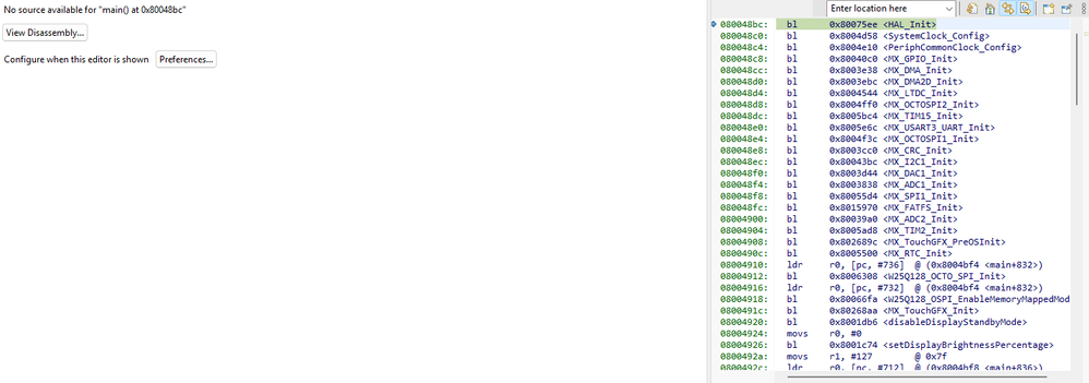

I’m currently trying to debug my project. However, as soon as I start the debugger, I always get the following error message: "No source available for main() at 0x80048bc". I’m using a custom board with an STM32L4P5ZGT6.

I start the debugger via the Debug Configurations I want to make sure the Debug build is selected and the correct launch file is used.
Flashing works, but as soon as the program is programmed onto the target I get the “No source available” message.
I’m using FreeRTOS and external memory (QSPI). Could this be related?
