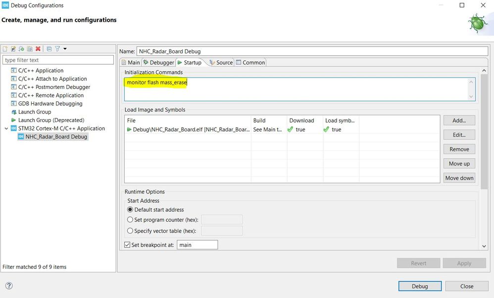

I think this works for a ST link debugger connection ; unfortunately not for a Segger Jlink?!
When adding "monitor flash mass_erase" to the debug configuration -> Initialization startup :

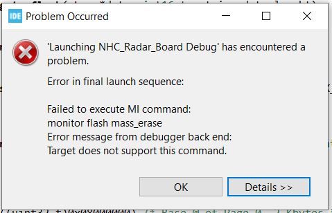

I get the following error :
Any suggestions?

Hello Diederik,
J-Link has its own commands which you can find more about in their user manual available here.
I believe the command for J-Link should be flash erase but you can double check that with the manual.
2022-03-14 4:52 AM
Using Segger J-Link the command is: monitor flash erase
