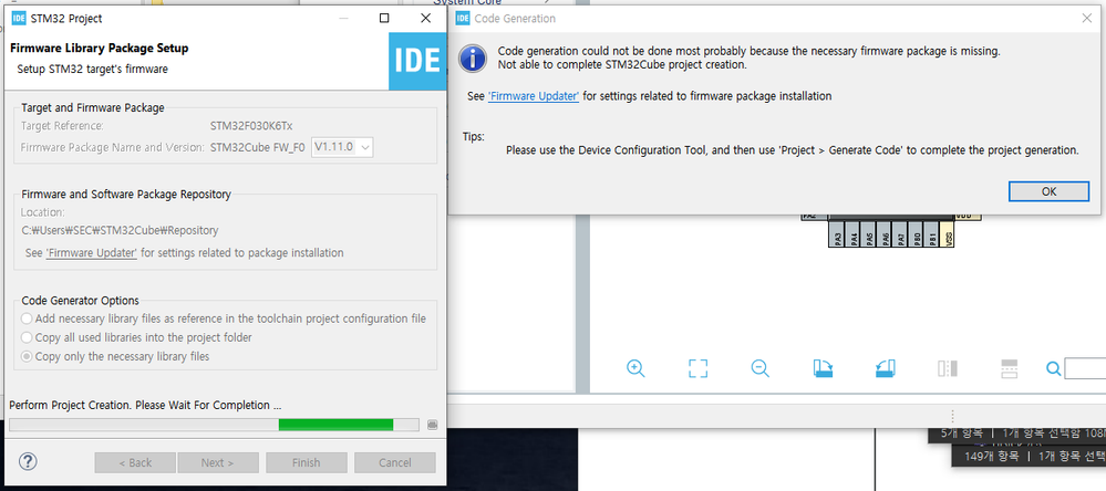

According to your screenshot, firmware version 1.11.0 was selected, which leads to the error visible on the right. However, the process can also be started if this version is not currently installed.

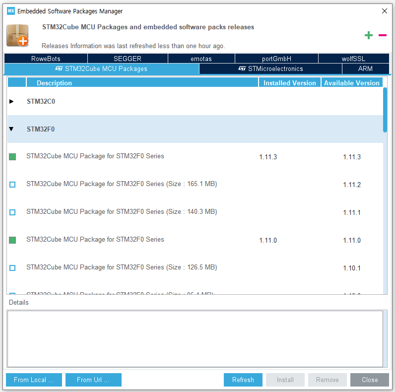

Are you 100% sure that under Help > Manage Embedded Software Packages > STM32F0 the version 1.11.0 is also marked as available?

confirmed through this window. Project creation fails for both installed firmware versions.
thank you for reply. plz help me.

I checked that it was built by importing the project that worked before. But I can't create a new project.

What if you open the "Embedded software packages manager" and remove the F0 1.11.0 package.
The tool should now detect that the FW version is missing and try to download and install it. And then generate the files from this FW package.
