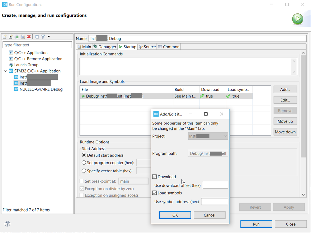

Try to edit the debug configuration to not flash on startup.
Debug configurations... -> Startup tab -> select the one you're using -> Edit -> uncheck "Download"

I'm using STM32CubeIDE Version: 1.10.1 , I can not find the option you mentioned.
Could you please attach a screenshot?
Thanks a lot.

I guess it is this one?
