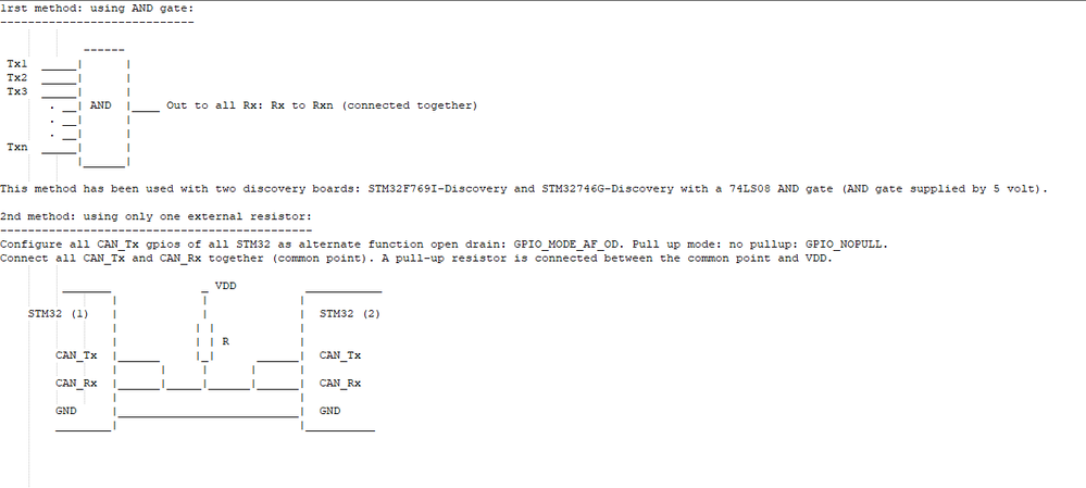

Using CAN in Normal mode without transceivers is not a common HW configuration for CAN bus.
It's used only for quick tests and the distances between nodes SHOULD NOT EXCEED few centimeters.
ST does not support this kind of config.
Meanwhile, (just a courtesy), I remember I did this kind of config years ago with STM32 MCUs and succeeded to establish the communication.
Attached two methods I remember I used for this kind of HW.
