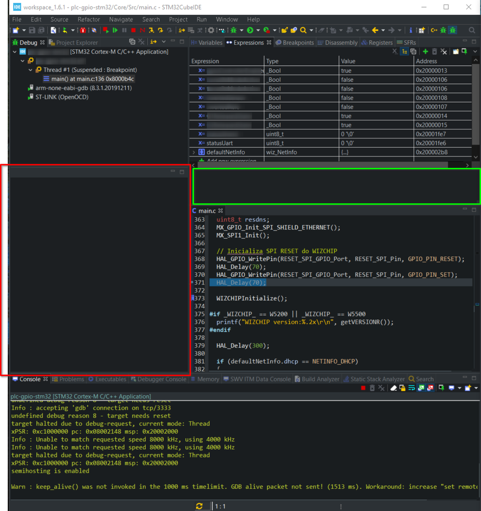

Hi, I would like to customize the debug perspective but I can't remove the selected windows. I want to remove the window with the red box to leave the main.c file in the entire horizontal space, but it is associated with the editor in C ++ perspective. I also want to remove the green box window which is practically useless. I welcome suggestions in this regard.

did you try to manage these view in Window -- > Show View ?
2021-11-08 8:47 AM
Hi, I did but they are not windows with specific functionalities. They are something like modules/windows of the Debug perspective.
I tried too with Window -> Properties -> Run Debug -> Perspectives ,but when switch of run to debug, the window in the red box load again the .c file

It works, thanks a lot @Julien D_OEHAUDT !!
