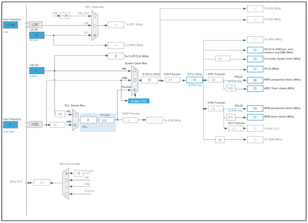

I get it to work, both led blink and HAL_UART_Transmit(...).
First of all i used the same offset(for the bootloader) as marlin 3d printer firmware for the creality board(in my code instead of ROM it is FLASH): https://github.com/MarlinFirmware/Marlin/blob/2.0.x/buildroot/share/PlatformIO/ldscripts/creality.ld
At the beggining i was't even able to tongle the pin, finaly i had to make some changes to clock configuration and everything worked:
One more issue i am facing is that the HAL_Delay() is blocking that is why i could not send in the while loop. Still not able to solve this but i used another way. Below you can find the source:
