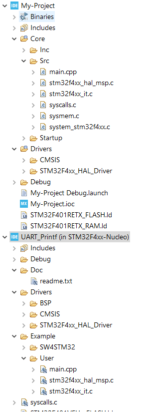

2020-10-14 12:32 PM
I've noticed a problem that is even deeper/weirder:
When creating a project from scratch, it works for me :
But when creating a project from an example(File > New > STM32 Project > Board Selector) or opening an existing project, the manipulation (right click > Convert to C++ and then rename the extension of main.c to main.cpp) dosen't change anything. ie : I can see on the compliation log that main.c (even though I renamed it "main.cpp" through Cube IDE) is compiled with gcc and not g++.
Also, very weird : If I double check in the windows explorer, the file is still named main.c. It seems that for some project architectures, CubeIDE and the compiler doesn't take into account the renaming of the file.
Below, a screnshot (top project (My-Project) does compile with g++ and bottom project (UART_printf) doesn't compile with g++) ¯\_(ツ)_/¯
Any tips or thoughts on that ?
main.cpp has to be in the Src folder and not anywhere else, maybe ?
Has anyone ever succeded in converting an ST32 example to compile in C++ ?
2020-10-14 1:50 PM
Any program source (.c or .cpp) has to be in the SRC directory, and any .h or .hpp file has to be in the inc directory. Having said that, there are some tricks you can pull:
