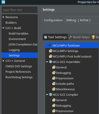

UPD: After a break I've decided to read the traceback properly. Turns out I only turned off fcyclomatic-complexity only for main.c, not for the whole project.
The problem is solved.
(for anyone else like me, you need to click on the project name and only then go to File, Properties, C/C++ build, Miscellaneous)

Nevermind, I think I've been able to answer my own question. The question LeonBoe asked is pretty simple in Cube 1.18.0. In the project explorer, right-click on top level project icon and click Properties (way down the bottom of the context menu) and expand C/C++ Build and click Settings. Then under the tool settings tab, expand MCU/MPU GCC Compiler, click Miscellaneous and the "Cyclomatic Complexity" option should appear. Since I started with the overall project instead of one of the component files, the setting applies to the entire project.
As far as the compiler is concerned, the location of the compiler appears in another place in the settings: In the Environment properties for C/C++ Build, the path to the custom version of arm-none-eabi-gcc appears there. I should be able to set the path at the command line when invoking the makefile and the option should be accepted by the version of compiler contained in the path.
