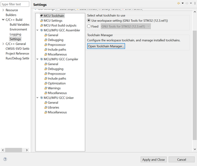

Open your project in STM32CubeIDE.
Go to Project Properties by right-clicking on your project in the Project Explorer and selecting Properties.
Navigate to C/C++ Build > Settings.
In the Toolchain tab, you should see the current compiler settings.

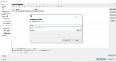

Change the Toolchain Path:
Modify the paths to point to the directory of your installed version of arm-none-eabi-gcc.
