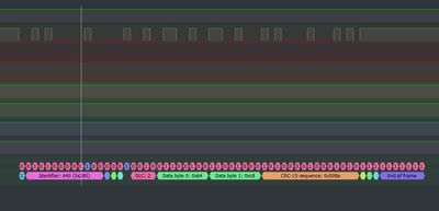

2024-09-26 6:53 AM
As you can see, Bit 1 is high for the ID. But i have programmed 0x180 for the 11bit ID, but somehow it sets the Bit1 high

2024-09-27 4:57 AM
The communication is all correct in external loopback mode. Only the can id is incorrect on one bit (bit1). No matter what id i chose, that bit stays high.
2024-09-27 5:26 AM
In that case you need to check your analyzer and its configuration. I don't think there is a an issue with the ID transmission.
2024-09-27 5:41 AM
I actually also checked with my oscilloscope. Same bit stays high in the id.
